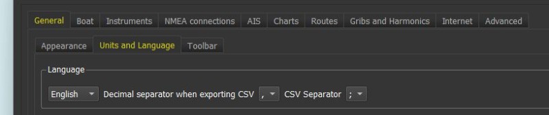

Either we have a bug in the export, either you didn't specify correctly in the general settings csv separator and decimal point for your localization. Excel is a bit dumb on that. You can also rename the file with a txt extension, open it in excel and it will ask you all about separator and decimal point.
There is no function for displaying graphs from the VDR, but once all data in a spreadsheet you can easily do it, or even write a macro for that.
