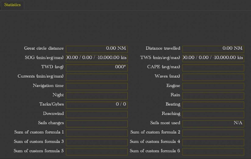

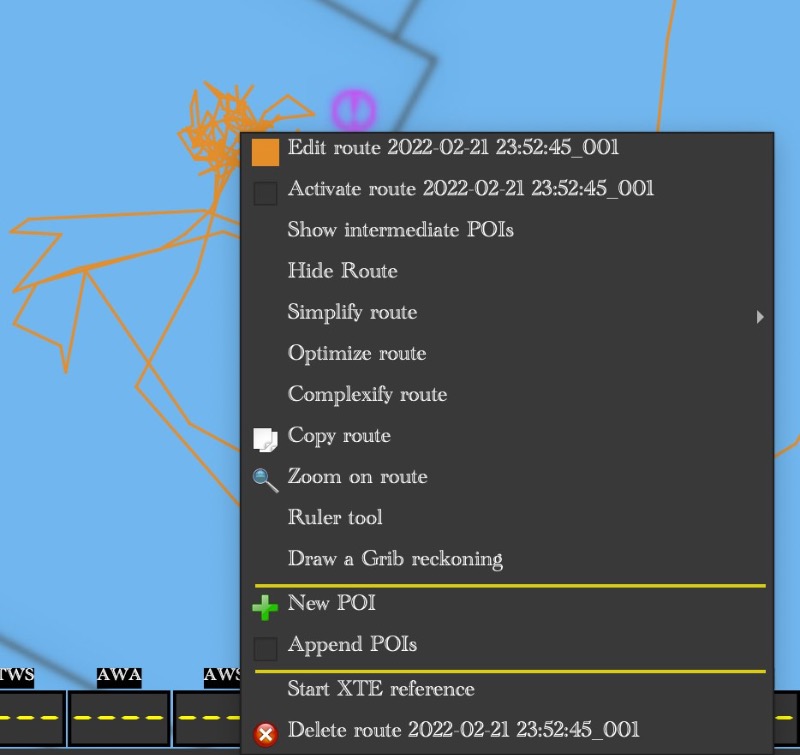

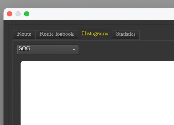

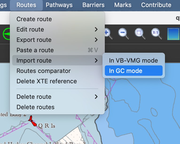

Hi, I opened this issue to collect a few questions that I have about importing a GPX as a Route on the Mac version of qtVlm. I want to import a GPX file so that I can view it on the chart and analyze the data inside the file (elevation and SOG for example). I import the GPX file using Route -> Import route -> In GC mode. I select my route on the chart and then select Edit route <route name>. I see the Route Settings window and select the Statistics tab but there is no data displayed from my route. I then select the Histograms tab and select SOG but nothing is displayed. Using other programs I have verified that my GPX file contains SOG data.

It's not a bug. An imported route is frozen and therefore cannot calculate stats. You can unfreeze it and it will calculate itself based on current grib data, which is maybe not your goal.
