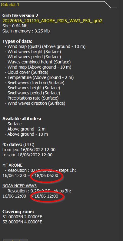

Attached* is a grib file with last weather frame at 2022-06-19 12:00 UTC, but routing doesn't go past 2022-06-19 00:00 UTC. Possibly related, frames are hourly until 2022-06-19 00:00 UTC, then 3-hourly until 12:00 UTC (3 more frames)
