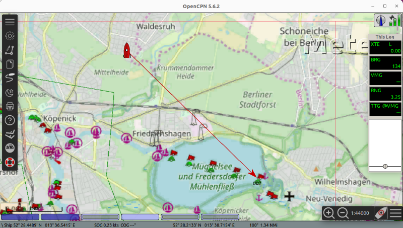

And now openCPN 5.6.2 under Ubuntu:
<BLUE>--> 20:37:32 (TCP:10.1.1.1:10110) $ECRMB,A,0.000,R,002,001,5226.177,N,01340.350,E,3.248,134.405,-0.196,V,A*4C
You see it is vice versa the openCPN documentation. Can you check it.
Made an check with avNav too which also gave To -> From.
This is my link:
www.nmea.de/nmea0183datensaetze.html#rmb
