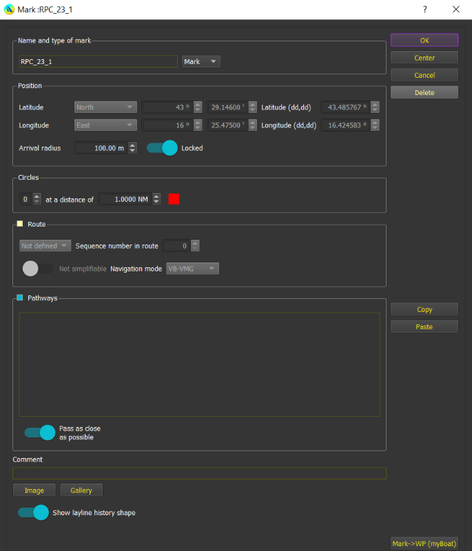

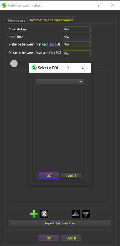

Hi,i created some marks and also a pathway.I can't add marks to a pathway and also the selection "pathway" isn't saved at the marks - when editing a mark always "path" is checked.Using 5.10-18 on Windows.Any ideas what i'm doing wrong?
Regards
Mike

Only POI of type "POI" can be added in a pathway. Your POI is of type "Mark" so it does not appear in the list
