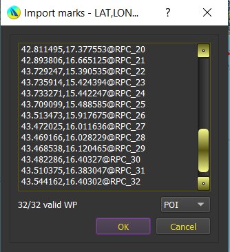

  • pocolocos
3 years 10 months ago #1505 by pocolocos
"Marks" - "Bulk add" doesn't work was created by pocolocos
If i'm adding marks in the dialog, they are shown as valid - but they are not added (also no error-message is apperaing).
I'm using 5.10-18 on Windows.
Any Ideas?
Regards
Mike
3 years 10 months ago #1506 by maitai
Replied by maitai on topic "Marks" - "Bulk add" doesn't work
Hi probably @ is not correct, this is intended for VLM mode to indicate an heading after the POI
You should specify @-1 to ignore it (and there is no way to give a name to the POIs with the bulk add).
