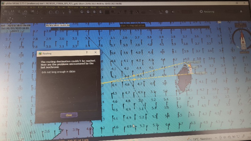

Hi first at all, thank you. Sails configuration well done.
Today suddenly, i try to do a routing....and appears a window reporting GRIB NOT LONG ENOUGHT IN DATES....But my routing yesterday was the same.

Your routing probably spans multiple days and yesterday the grib end date was still after the date of arrival and today the grib end date is before the date of arrival. Did you try downloading a new grib file?

I recharge the new version, i discharde new grib but the error reamain same
