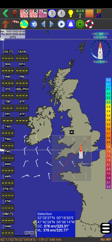

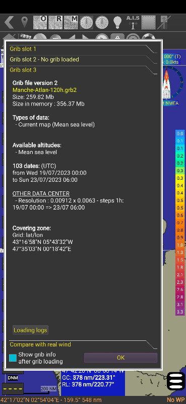

I'm trying to open relatively large grib files on my android phone. There appears to be a file size limit, which is fine, however when I select a smaller zone in qtvlm before opening the file, the coordinate range it opens is not the selected area. It tries to open an area south of the selection, for which there is no data.
Can anyone reproduce this error?

You are right, there is a small bug that I just fixed, thanks for reporting that.
That will be in the next version, in the mean time you can select a much bigger zone than what you really need and that should be OK.
