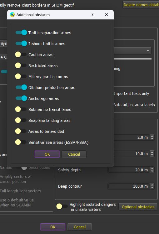

When Creating a Route, qtVlm continues to calculate and plot a course that trangresses my defined Safety contour depth...and even Shallow contour! I can't seem to find a setting in (Alt-R) Options or Advanced Settings that says, "don't create a route that takes the boat into water shoaler than my defined safety contour." Please let me know what I can do to correct, thanks!

Safety contour is a danger, not an obstacle. Shallow contour is an obstacle and should be avoided by routing. Make sure that
1) Dangers/obstacles by S57 is selected
2) You do have S57 at that place
3) In routing avoid land and barriers is checked.
4) In routing just reset values to default or select automatic setting with quality slider fully to the right
A screenshot might help, as usual

1) I couldn't find "Dangers/obstacles by S57" in the Routing options menus, Do you mean activating Configuration/Charts/"Coast lines from vector charts S57/63"?

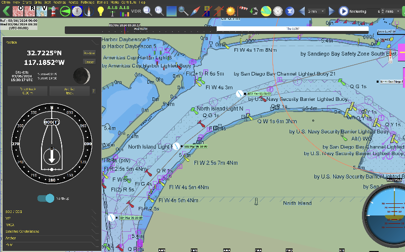

Same starting and finish points. Results with your above 4 areas attended to are...
The routing course is no longer going over Shallow Contours! But it is directly passing over 1 obstruction, 1 dangerous wreck and almost directly over 2 ATONs. The routing course is thick red in those places, as if it knows it's crossing a hazard.

Meanwhile, I understand the difference between dangers (objects <= Safety Contour) and obstacles (objects <= Shallow Contour), but are you writing that we are not able to have qtVlm calculate routing to avoid Safety Contour? That qtVlm routing will only avoid Shallow Contour? That's cool, users can input their Safety to equal their Shallow, I'm just wondering.

I haven't used qtVlm to route in Berthing (usage band) charts near any marina slip or mooring spot because we captains should be actively piloting inshore navigation. The first and the final 15 minutes of passages are usually the most complex. But even if I wanted to route to a marina via qtVlm, consider as noted herein and as seen in the example screenshot
that qtVlm routing doesn't properly account for fairway, narrow channel and traffic separation lane rules. That’s a problem. Meanwhile, I don’t understand what “points without geometry” means but qtVlm routing taking a boat right over ATONs and other real-world obstructions is also impractical. Third, unless I missed something, currents aren’t factored into qtVlm route planning.=10.0ptSo I've been creating routes in qtVlm using terminus points that mark channel entrances, such as lighted bell buoys. My routes cross relatively open waters.=10.0ptWhich is why I do not want my routes to cross the Safety Contour. My primary question for this thread still stands - are we not able to have qtVlm calculate routing to avoid crossing the user-defined Safety Contour?

Routing is not designed for that kind of approach. You use routing when traveling on long distances. Do you really expect the routing to avoid a low here? A route is much better, and in that case a pathway with with a safety check envelope is probably even better, and will account for obstacles that are points.
Wrong. Please read documentationqtVlm routing doesn't properly account for fairway, narrow channel and traffic separation lane rules.
Wrong. You are indeed missing something. Load a grib with currents or force currents.Third, unless I missed something, currents aren’t factored into qtVlm route planning.
Safety contour is not an obstacle. If you want to have a shallow contour at 20m it is your decision.we not able to have qtVlm calculate routing to avoid crossing the user-defined Safety Contour?
