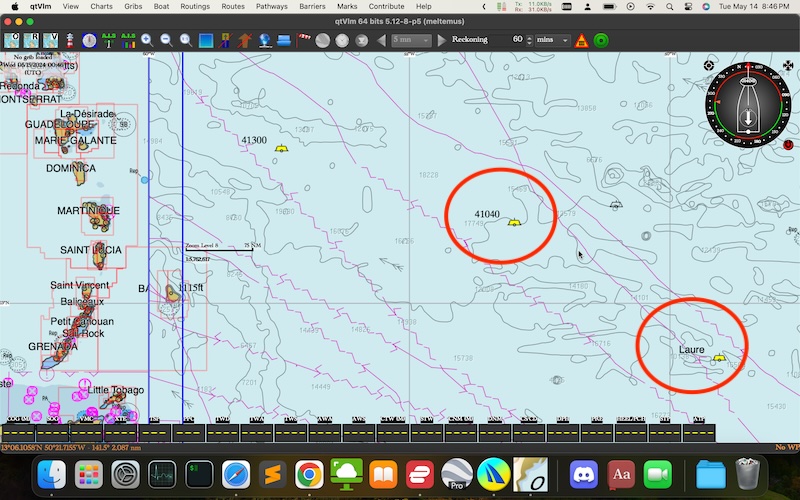

I have qtVLM and the Caribbean chart pack. In the image below are two yellow trapezoids which I have circled in red.
What are these?
In one of the circled areas, what does 'Laure' signify?
What does the number next to it (41040) signify?
I right click, select vector chart elements and get a dialog that says it's a special purpose buoy
FL (4) 20s
So FL means fixed light
Does (4) mean visible for 4 miles?
what is happening at 20s?
What are these?
FL (4) 20s

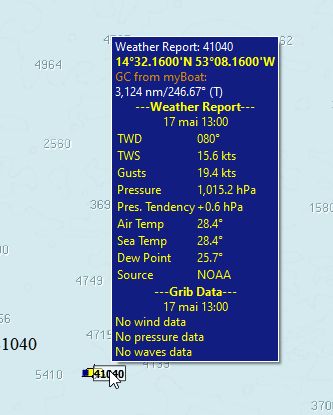

These are special purpose buoys, in that case ODAS (Ocean Data Acquisition System) which you can learn via the pick-up report (right-click, vector chart elements). Laure is just the name of the buoy, as is 41040
FL 4 20s means a Flashing Light visible at 4 miles flashing every 20 seconds.
A Fixed Light would be just F
See this post for a similar question: www.meltemus.com/index.php/en/forum/qtvl...hart-packs-rncs#2503
Btw if you load weather buoys data (right click, weather stations download), you will even learn about the data the buoy is collecting

thank you for that. I could reproduce this info for marker 41040 but not for the others (41041 or 41300 or Laure) Does this mean there is no data for those markers?
2 years 6 months ago #2548
Replied by maitai on topic What are these symbols?
I suppose the data for these stations is not published by NOAA.
