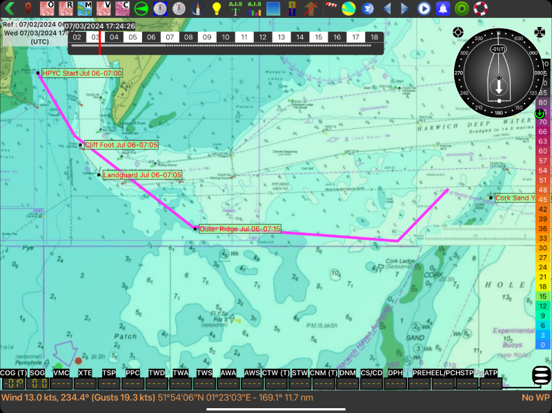

The 1st thing I observe is that even though I add all the marks in order sometimes marks are missed or skipped. For example in the picture below I added Languard after Cliff Foot and before Outer Ridge but the path plotted seems to have skipped Landguard.
The 2nd thing ( in the same picture ) is that I add Cork Sand after Outer Ridge and the system seems to have added a strange leg and not made it to Cork Sand. Finally whenever I click on Route Legend to view the entire route the app crashes and the route is lost.

First of all the crash is absolutely abnormal. More info is needed, to start with what do you call "Route Legend" that wording does not exist in qtVlm.
Then a route is a complex object that calculates ETA between points and the best way to reach a POI. On you screenshot we see that several points have the same ETA, meaning either that the distance between points is ridiculously small or that your polar is for a really fast boat. Which polar are you using ?
qtVlm uses a internal step of 5 minutes (unless you changed that, did you ?), and therefore a route can never reach exactly a POI, it is either before or after it. I don't want to enter to much in the details, but a POI will be considered reached if within the last 5 minutes distance (it is more complicated than that).

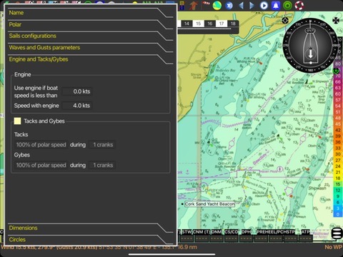

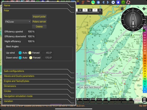

The main question is: can you post your polar and show boat->boat's settings polar and engine/tack tabs ?

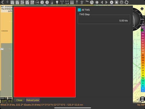

I do not seem to be able to see the polar, or any polar, even the ones included in the polar directory. I just get a big red square, its the same on the iPhone.

Attached are the screenshots you requested. I have not changed much.
