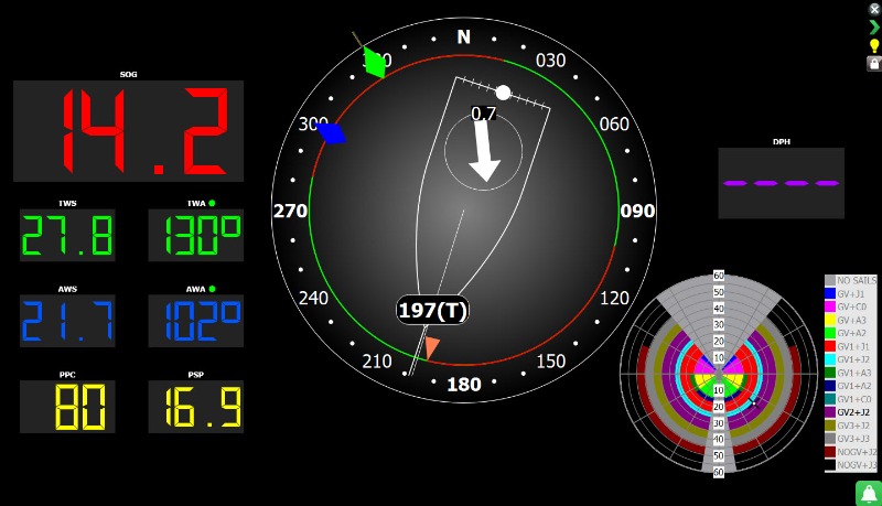

2 years 1 month ago - 2 years 1 month ago #2704 by ourasi
Replied by ourasi on topic sails file content
Hi Roby,
You can create your sailselect and saildef manually,but you can also use this excel spreadsheet (see attached: polar_master.xlsx - just remove the .txt extension once you downloaded it). This spreadsheet is fully customizable, just make it yours according to your sail set, boat specs...  Then it gets very usefull  in case you just need to change your saildef ou fine tune your sailselect. 3 main tables you can play with (CODE, HEAD SAILS and MAIN), saildef and sailselect data will adjust automatically. Follow the instructions to create your files and eventually you'll end up with a similar QTVLM sail instrument (see pic attached).
Enjoy!
