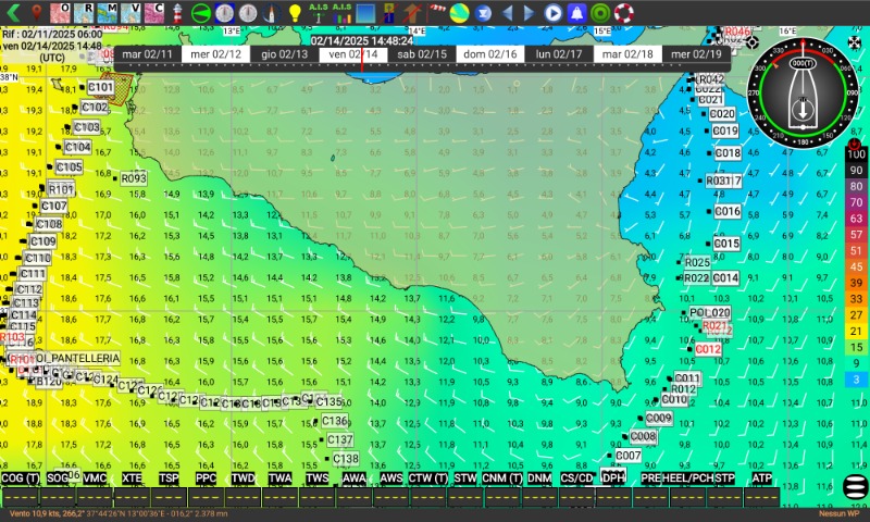

I had set up barriers, a patway, two routes.
The application was open on the tablet.
At some point the Routage,Routes and Pathways functions appeared disabled in the menu.
I closed the application and reopened.
The barriers remained, but the pathway and routes are deleted.
Only some POIs (?) appear as in the attached figure.
https://drive.google.com/file/d/1Rj6DVFBZE4OGH7D8Fkzwc0soEIZ7Qwpe/view?usp=sharing

I have never seen such a case, but to my understanding it seems that at one point when you relaunch qtVlm your complete license was not recognized by Google Play and therefore since routes etc are only with complete version you lost them.
Only thing I can suggest if that occurs again is to make sure to do "Quit without saving", in order not to save the empty route situation, then restart your device.
