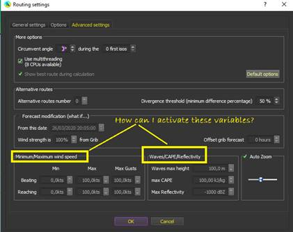

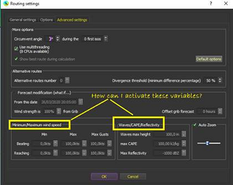

Hi !
How can I activate these fields? Waves/CAPE/Reflectivity
These variables can't been configured when the route is being generated.
Can these parameters be unlocked so that the software allows configuring a routing with a certain maximum wind speed and a maximum wave height?
Thank you

6 years 4 months ago #273 by maitai
Replied by maitai on topic Waves
These fields are disabled if automatic settings is checked in the first tab, to avoid mistakes.
I recommend you move the slider to Maximum Quality before you uncheck "Automatic Settings".
Regards,
Philippe.

6 years 4 months ago #274 by lord@accionservicios.com
Replied by lord@accionservicios.com on topic Waves
Thank you very much for the reply. It has been very useful and fast !!
