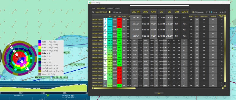

i am also experiencing an issue where the awa and aws are not calculated in the route logbook, please see attached image with an example of this. please let me know if my configuration is somehow causing this problem. thank you.

For AWS/AWD in logbook again it is very strange. All the routes are like that? When it is 0, what are the values of TWS/TWA./STW on the same line? The route is imported ?

for the route issue... tws and twd and stw all show what look like valid values. the sails column shows n/a (though i have configured the files for my sails instrument display.
the routes were generated by qtvlm, i did a multi route generation from a pathway, using three different grib files. all of the routes have the issue.

OK for the route, that was a multi-grib routing. I will fix that.
