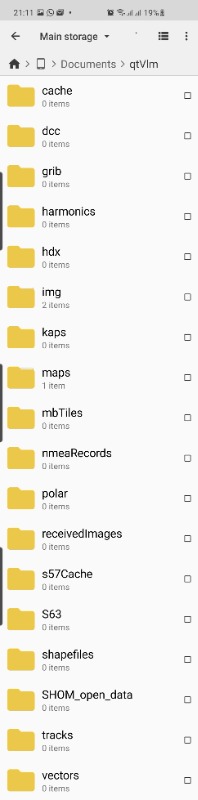

4 years 10 months ago #1168
Replied by maitai on topic Maps Not Found
OK. Last question before next year :
Can you post a screenshot of what you see/have in Documents/qtVlm from android file explorer and/or Windows File explorer ?

- Artras
- Posts: 16
4 years 10 months ago #1170
by Artras
Replied by Artras on topic Maps Not Found
Screenshot of what is inside directory Documents/qtvlm after instaling
