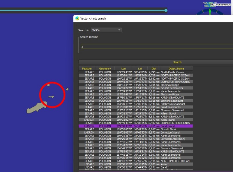

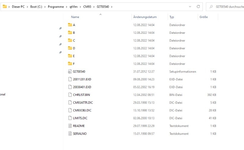

The data hierachy is as follows:
cm93 folder contains multiple subdirectorys. Only one on those subdirectories contains a .dic file. So when i reference in qtvlm to this single subdirectory, how does qtvlm can know about the others ? .
The complete (parent) cm93 folder contains every zoom level (checked with opencpn).
cm93- 12345678
-x2345678- A
- B
-.dic
-.obj
cm93- 12345678
-x2345678- A
- B
-.dic
-.obj

Replied by oxygen77 on topic Maps Not Found
The folder that you select in qtvlm should be the one that contains the cm93attr.dic file and folders with names that are composed of 8 digits.
We do sanity checks in qtVlm that might not be present in opencpn.

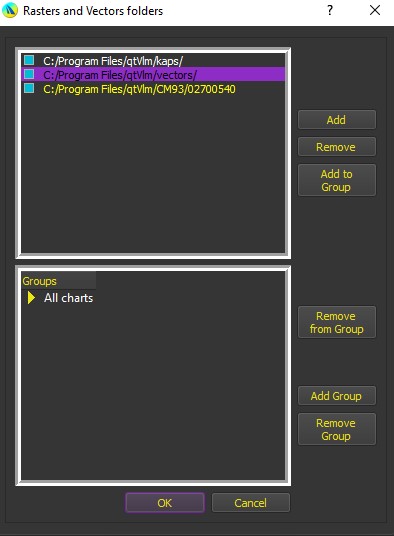

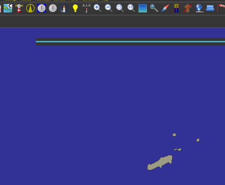

i found a quick and very dirty way, but it worked for me (though not knowing why this is working). Probably this will not !! work for other users, i quess my data collection is not in the original sorting.
_______________________________________
Only for those who have experienced the same issue, i do write my solution:
Summary: my data set contains numerous folders with 8-digits, Only one contained the CM93ATTR.DIC file. I moved the files in that folder to the top level (dirty) , made this level the reference path for qtvlm. Afterwards i copied the data of the folder with the highest digit number (the newest) into the same level (e.g. Subdirectory A contains now data from both 8-digit folders).
I made different cross checks with the charts in opencpn and found no differences. up to now.
